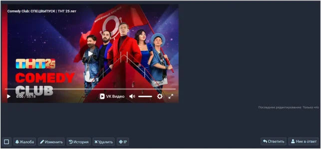

Hi. There's a problem. Nobody knows how to solve the problem of processing video from VK Video? It used to process URLs from VK Videos, but now it doesn't.
I just figured out how to manually output the video correctly, I'm showing you an example:
There are videos, for example: https://vk.com/video-131607049_456240812
There is an option to export it by code:
<iframe src="https://vk.com/video_ext.php?oid=-131607049&id=456240812&hd=2" width="853" height="480" allow="autoplay; encrypted-media; fullscreen; picture-in-picture;" frameborder="0" allowfullscreen></iframe>
None of the options will output the player to XF. To solve this, we take
[MEDIA=vk]hash=****;oid=-****;vid=****[/MEDIA]
Where **** should be substituted as follows, as in the example below:
[MEDIA=vk]hash=131607049_456240812;oid=-131607049;vid=456240812[/MEDIA]
There's no support here on the forum, so I'll show a screenshot from mine.
Any idea?:unsure:
XF: 2.2.12
PHP: 8.0.30
s9e/MediaSites: 2.15.6
That'll be fixed in the next update. VK does a thing where it checks whether it's a browser accessing the page, so the add-on has to pretend to be a browser in order to retrieve some of the IDs. They also check whether it's a recent browser, so the add-on needs to be updated whenever VK update their requirements. Currently the add-on pretends to be Firefox 62 ESR, next update it will probably pretend to be Chrome 124 and from what I can tell that should fix it.
In the meantime, you can either craft the BBCode manually as you described, or post the full URL of the video which can be found in the page's source, and possibly in the "Share" menu which I can't access because I don't have a VK account. In this case, this:
https://vk.com/video_ext.php?oid=-131607049&id=456240812&hash=f28d20fc3d6edcb6
