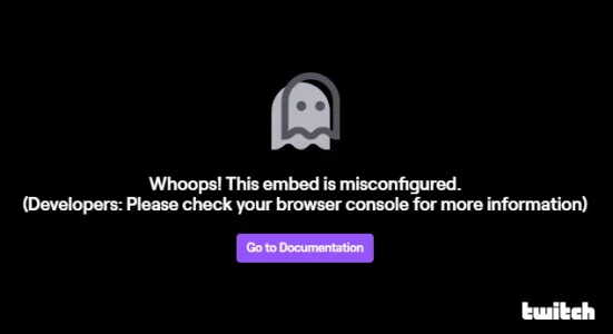

Unfortunately its still not embedding properly and showing the same twitch image/message. Is there anything I can do to help solve this issue?
The first step would be to make absolutely sure that you're using the latest version of the add-on, because I don't think you are.

I updated Wednesday after you uploaded a new file and I could have sworn it didn't work. I just tried again after your comment about my version probably being out of date (20200722), and now it works. So you were right. Thank you.
Just for clarification: 2020-07-22 copy fixed twitch issues everyone!

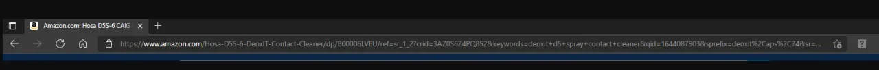

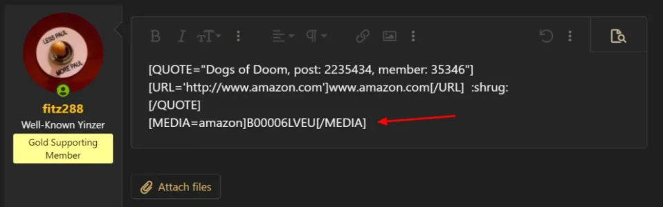

Thanks for this great addon. There is an issue that amazon links to non product pages are also getting converted to a media embed.
E.g. https://www.amazon .co.uk/gp/help/customer/display.html?nodeId=201834890
Possible to not alter the link if it's not to a product?

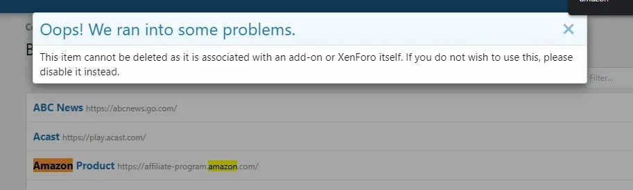

Amazon is a media site and I suppose you have auto-embed enabled. You can disable the Amazon media site if you don't want those links to be converted.
What version of XenForo is that? This thread is about the XF 1 add-on and I don't have a version of PHP old enough to run it, but the add-on's page says this: "You can configure which categories of media sites you want installed in the Admin CP by going to Home > Options > s9e Media Pack." There should be an option there to disable Amazon.

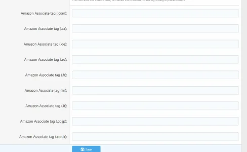

Yes, they are empty unless you fill them.
