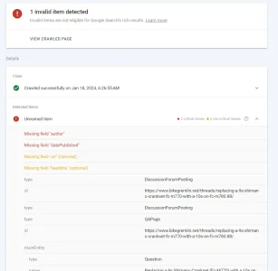

So after updating to patch 2... I got this message from Google search console.
Search Console has identified that your site is affected by 1 Q&A structured data issue(s). The following issues were found on your site. We recommend that you fix these issues when possible to enable the best experience and coverage in Google Search.
Top non-critical issues‡
Missing field 'text' (in 'mainEntity')
‡Non-critical issues are suggestions for improvement, but do not prevent the page or feature from appearing on Google. Some of these issues can affect your appearance on Search; some might be reclassified as critical issues in the future.
Just wondering if this is something specific to my install or others are getting the same message. Before update, this particular section had zero issues.
