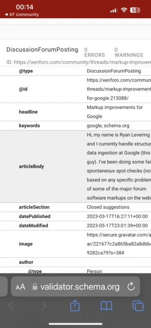

We can certainly look into it further but I'm not entirely sure the Validator isn't wrong.
Our markup:
HTML:
<h4 class="message-name"><a href="/community/members/sdev.97451/" class="username " dir="auto" data-user-id="97451" itemprop="name" data-xf-init="member-tooltip">sdev</a></h4>
The error:
namePerson is not a known valid target type for the name property.
@typePerson
@idhttps://xenforo.com/community/members/sdev.97451/
Pretty sure our markup here is saying that the name property should be sdev i.e. the content of the element that is applied to.
@Jeremy P what do you think?
If the element is an a, area, or link element
The value is the resulting URL string that results from parsing the value of the element's href attribute relative to the node document of the element at the time the attribute is set, or the empty string if there is no such attribute or if parsing it results in an error.
That's most likely the reason why the current markup doesn't fully work:
The URL of the user profile (from attribute href) becomes the value.
This URL is also the ID of the Person - hence the error message that Person is not a valid target for the name property of a Person.
HTML:
<h4 class="message-name"><a href="/community/members/sdev.97451/" class="username " dir="auto" data-user-id="97451" itemprop="name" content="sdev"  data-xf-init="member-tooltip">sdev</a></h4>
seems to make the validator happy, eg. does give the correct result - not sure though if this approach would be fully valid.

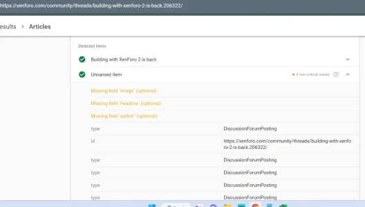

I noticed that in DiscussionForumPosting that the keywords key is empty. Could you use tags to use as keywords for that key? Running the schema through Bard, it's telling me that we're missing replyCount too.
Regular threads look good but articles still have issues.
Those are from mainEntity attributes in post microdata to associate the reply with the original post (which actually does have the supposed missing attributes, just in a separate JSON-LD node). It does look as though we'll want to fetch the type from the given thread type rather than hard-coding it as DiscussionForumPosting, but that doesn't seem to make a difference here.
I'm not entirely sure if there's a better way of associating the comment nodes (in microdata) with their parent node, or if there is just an issue with the way it is parsed by the validator.
