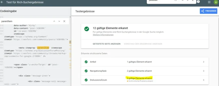

This is the main issue - it seems that neither mainEntity (as used by XenForo 2.2.13) nor parentItem does work to correctly nest the Microdata Comment under the JSON-LD DiscussionForumPosting.
@rrlevering
Can you confirm that
<meta itemprop="parentItem" itemscope itemtype="https://schema.org/DiscussionForumPosting" itemid="https://xenforo.com/community/threads/markup-improvements-for-google.213088/" />
should work to correctly nest a post (Comment) from this thread under its DiscussionForumPosting?
Or could you give a complete short working HTML example of a Microdata Comment correctly nested under a JSON-LD DiscussionForumPosting?
Not sure if it's the same issue being parsed differently, but after making the relevant changes the validator actually seems to indicate the comment nodes are valid, but it instead complains that the linked DiscussionForumPosting does not have the required attributes (which are present in the JSON-LD). Maybe the validator is not taking syntax merging into account yet...?
Maybe got it working?
Actually yeah, it seems the parentItem isn't being parsed correctly :( As @Kirby said, an example would be lovely.
As I mentioned in my last post, just change Comment -> mainEntity to Comment -> parentItem and that structural problem will go away. With that change, this exact forum page here will parse fully valid. Syntax merging should work fine currently.

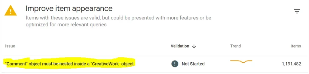

The other issues (only image comments and deleted authors) don't show up as much in our web diffs, but we'll work on fixing them next round of updates. These are likely not leading to problems in our ingestion, it's just a reporting issue.4ekd6wNHaipVgdB.webp
Thank you very much for the reply.
Unfortunately it seems like I must be doing smth. wrong as this doesn't seem to work correctly for me:
If I apply this change the test tool detects X (= amount of posts on the page) unknown Comment with a parentItem DiscussionForumPosting and one known DiscussionForumPosting without any Comment while there should be just one DiscussionForumPosting with X Comment?
For this thread page the tool currently shows 9 DiscussionForumPosting
This doesn't look right to me - also the repeated type DiscussionForumnPosting seems strange?
I therefore still think that a fully working example would be awesome :)
