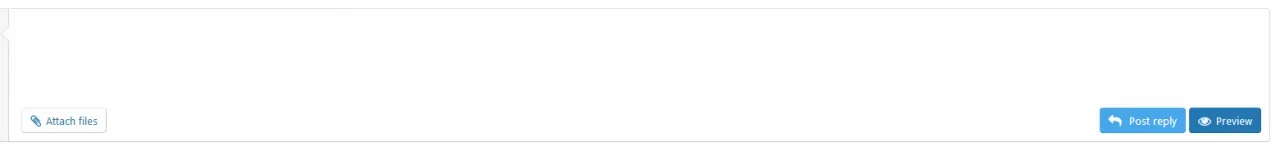

Editor box are not showing with Delay Load. This option will are not show Editor BB icon but plan box show?
That's what delay load should do: https://my.mixtape.moe/xnhnrm.mp4

Yes I do understand but its box are not show without hit.
Seems like the styling is missing. Is the video from an online accessible installation? If so, would you provide me with a demo login so I can have a look at it?

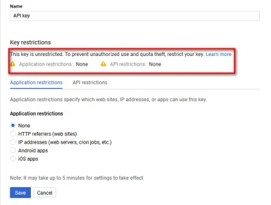

How to enable Google Fonts API Key unrestricted?
Google is telling you that potentially everyone could use your API key and asks you to set up some form of limitation. I suggest limiting it to the IP address of your server.
Check your PM.
Done Application restrictions but No need set for API restrictions?
