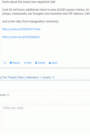

OK but using post Reply button will be post in 2nd line with enabling this add-on, I have disabled this add-on and post Reply button not post in 2nd line. Please can be more check why this happen?

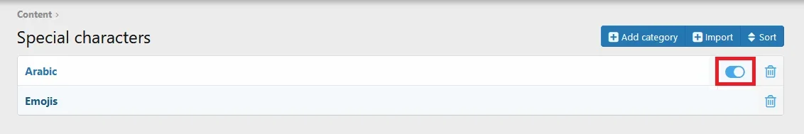

Yes only this happen when enabled this add-on. How can add Special Characters?
Please can be add functionality On/Off button for Special Characters. So we can disable without deleting. Also add category Display order.
@katsulynx is this a design error, or there's no workaround?
While "delay load" is enabled, the select to quote is not working, unless the editor is activated.
There's currently no workaround for that. The multiquote and reply want to trigger on the editor object, but as the editor object will only load if you click into the text field, they can't.
The way this feature is implemented, that is not possible. The whole content of the section is parsed directly into the data that is transmitted to the user. I didn't deem it appropriate to blast the database with a potential 10.000 entries or more table just for this little feature.
Use the sort button for that.
