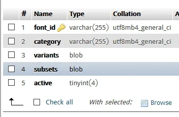

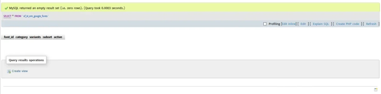

Its will that my IP are not restrictions. Now getting other error from manually start.
XF\Db\Exception: MySQL statement prepare error [1054]: Unknown column 'subsets' in 'field list' src/XF/Db/AbstractStatement.php:212

Yeah, that's an awkward misspell that I did with the first version of the last update. I have a patch inbound for that for the next update, but if you don't want to wait, go to your database and rename the column subset in the table xf_kl_em_google_fonts to subsets.
