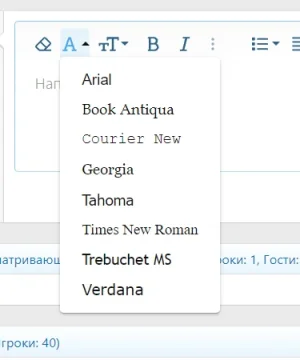

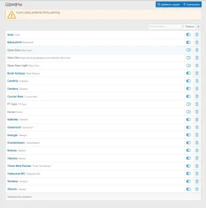

Yes, thank you, already. Apparently this is a style problem, some things are not displayed, although they are.
The default style does not display all additionally added fonts.
Can you show me the screenshot what fonts are not display?
