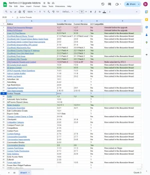

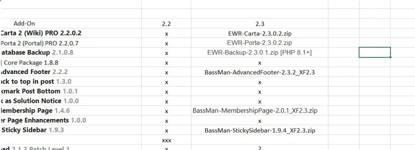

Since the addon is redundant, it should be uninstalled before upgrading XF to 2.3. In future, for a major upgrade such as this, may I recommend making a spreadsheet of all your addons and organising what to do with each of them?
I will also be uninstalling
and
before upgrading as they are also redundant.
