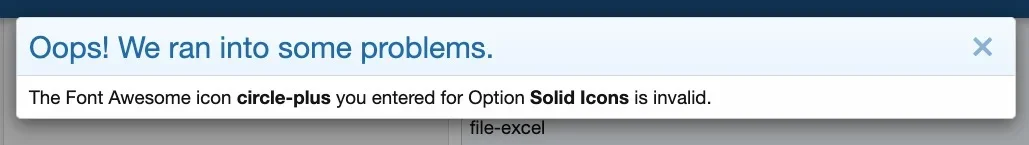

Hi @Kriby: Im am using the subfonter variant in your addon and do have some issues with adding certain icons. I.e. if I want to add the "circle-plus" (which should be free)

in Font Awesome Manager I get this message:

Had this with a couple of icons, all free, all with a dash in their name (Probably conicidently). Adding other icons worked flawlessy (i.e. plus w/o the circle). Any idea what may be causing this or even how to solve this?
XenForo uses FontAwesome 5.x (not 6.x), circle-plus does not exist in version 5.x.

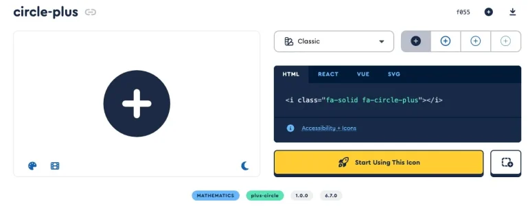

FYI, you would be able to use that version 6 icon in XenForo 2.3+. You can download any "free" version 6 font awesome .svg and add it to the appropriate directory in XenForo. In this case it is a solid icon, so... /styles/fa/solid/circle-plus.svg

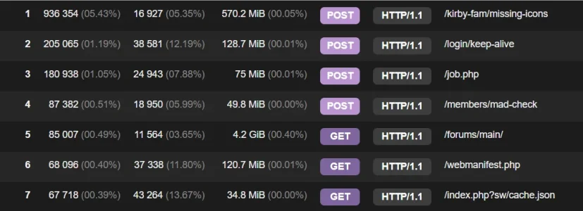

I checked the page load statistics.
In first place, with almost 1 million downloads in two weeks, is some address from this plugin.
Is this how it should be?
ХF 2.2.13
@Dkf
I don't understand that language (whatever it is?), but the HTTP POST /kirby-kam/missing-icons happens if there are missing icons and option Automatically add missing icons is enabled (which should not be enabled on production systems).
