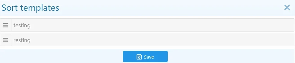

Users are unable to sort templates.
error:
Error: Cannot use object of type KL\EditorManager\Finder\Template as array in src/addons/KL/EditorManager/Pub/Controller/Templates.php at line 256
    KL\EditorManager\Pub\Controller\Templates->actionSort() in src/XF/Mvc/Dispatcher.php at line 352
    XF\Mvc\Dispatcher->dispatchClass() in src/XF/Mvc/Dispatcher.php at line 259
    XF\Mvc\Dispatcher->dispatchFromMatch() in src/XF/Mvc/Dispatcher.php at line 115
    XF\Mvc\Dispatcher->dispatchLoop() in src/XF/Mvc/Dispatcher.php at line 57
    XF\Mvc\Dispatcher->run() in src/XF/App.php at line 2351
    XF\App->run() in src/XF.php at line 517
    XF::runApp() in index.php at line 20

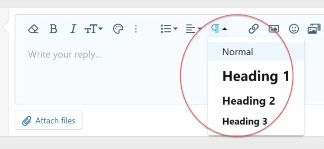

Appreciate the update, just tested but Heading bbcode buttons are still not appearing when the add-on is active, any workaround possible?
