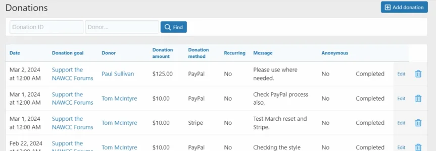

I have made two donations, one each in PayPal and Stripe but the results do not appear in my display. The donations do appear in the donations list. I can edit the progress amount to make the donations appear, but they are not updating automatically. Is there a cron job that updates the goal's total donations?

I edited the donations to see if adding the goals would fix the progress display. Before that edit the recent donations all read N/A.

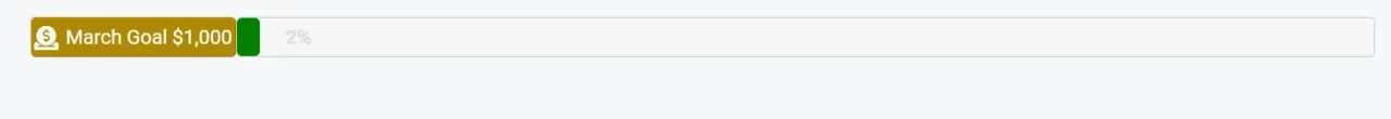

This is what appears currently. Note that I edited the Donate phrase to show the Goal name and goal amount. I wish the progress bar outline and percentage were a different color. This is the live site and I do not control the account receiving the funds (we are a not for profit corpiration.)1709650883114.webp
In looking at this I saw I could "fake" a donation in the donation list. I added another $100 dollars with the above result. The actual amount of the donations in the list is $220. It was $120 before the fake donation I just added.
I deleted the fake donation and it went back to the first image above.

It only shows N/A if the donation was made when the goal was inactive/expired.

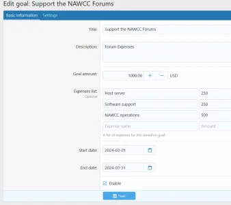

The goal says it is active, but the donations do not get assigned to the goal. There is only one goal.

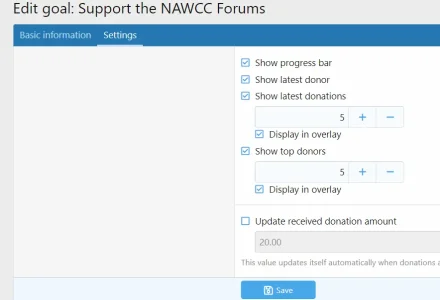

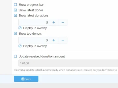

Out of curiosity, I disabled the option to display the progress bar. The display did not change and the progress bar is still displayed. The $170 in the donations received amount is the result of me editing that value after checking the update check box.
You are using a modified version of the template where you wanted only the button and the progress bar.
