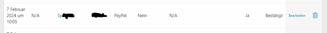

since probably a few days, I was most likely able to receive donations until February 7th, the donation function is broken. If you click on one of the links of the payment service providers (I have Paypal and Stripe), you get the error message "Oops! We ran into some problems. Please try again later. More error details may be in the browser console."
I tested that the payment providers are generally accessible using the upgrade function. There are no other error messages.

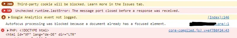

What does the error say in the browser console?

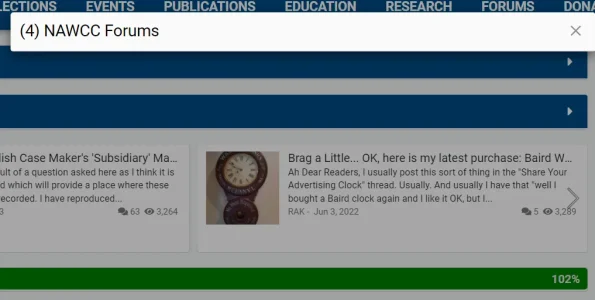

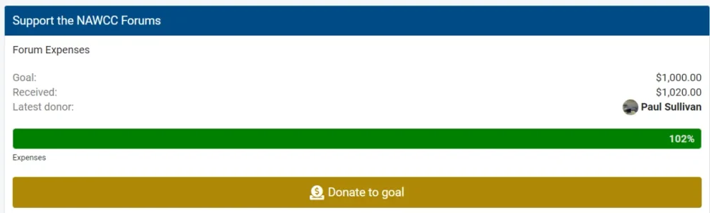

I replacd the code with the above but there is no effect from doing that. i.e. nothing changes.

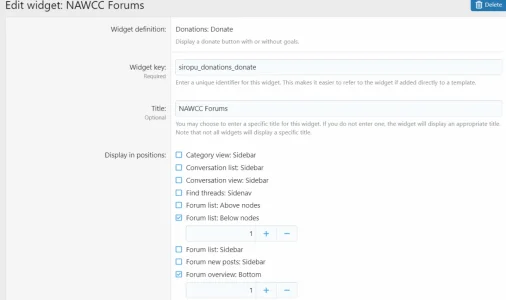

Below is the appearance of the donation widget.

The donation button is fine, but the action fails after selecting the payment system either PayPal or Stripe.
I replaced the entire widget template. Was there part of it that should have been retained?1708469350220.webp

I had the templates confused. When I reverted the one I had replaced in error evrything worked.
