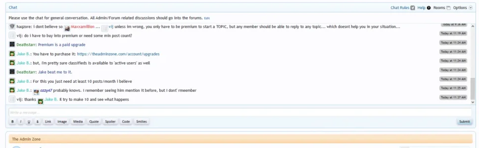

This is another chat freshly installed on a stock style just to give you an example or how I think something should look out of the box:
Not:

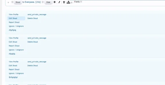

Side note what are the hidden menus?
It looks like it's literally showing a menu for every single message that is posted.

Side note what are the hidden menus? It looks like it's literally showing a menu for every single message that is posted.
That's correct. Since each shout has a different context (e.g. we shouldn't show the "Ban User" menu item for users that are in a protected usergroup), it made the most sense at a time to pre-generate hidden menus via jQuery Templates so they could be loaded and unloaded each time the Shoutbox fetches new shouts.

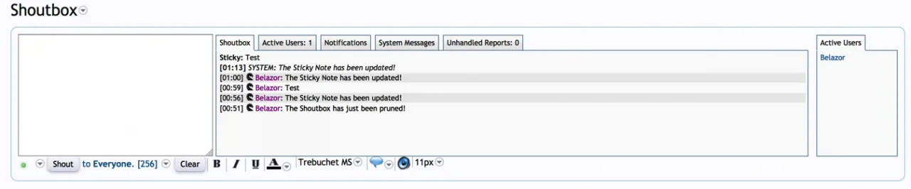

@Russ @bgandy Here's a preview of the new design in Beta 3:
I've gone through every template and ensured that inline styling is only used where variables from PHP is used, and ensured there's no colour definitions anywhere in any CSS template - it's all using xF's style properties.
I've also significantly reduced the amount of templates used by consolidating code and removing dead weight as a result of the new simplified shout area system. The CSS templates have also been trimmed of useless definitions, and the dbtech_vbshout_colours.css template has been entirely removed as a result.
I'm going to look into what I can do to use the member card instead of custom menus, while still maintaining functionality. I do agree that using the member card would be superior to having to create a bodged menu, I'm just unsure how I would actually achieve it.
Again, thank you both for your feedback, you've both helped make the mod that much more awesome :)
