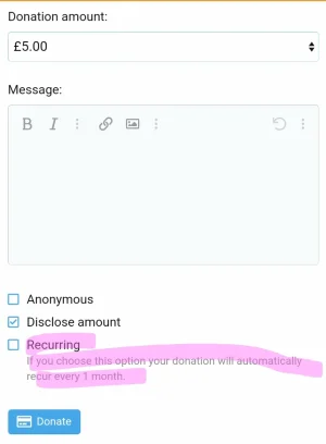

This only works when products are specifically defined as either single or recurring.
If a product can be dynamically set, then there's no option to choose different payment profiles.
For example, theme house donate, there's just a checkbox, it wouldn't make sense to also click a payment profile here.

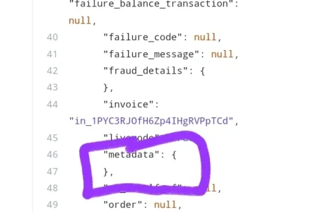

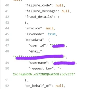

Just had my first recurring payment and it failed.
The reason seems to be there is no "request_key" (or any other field) in the "metadata" array passed through to the webhook.
Single payment:
Recurring:
Ah it seems recurring use the callback to invoice.payment_succeeded instead of charge.succeeded which xen gives error "Event data received from Stripe does not contain the expected values."
