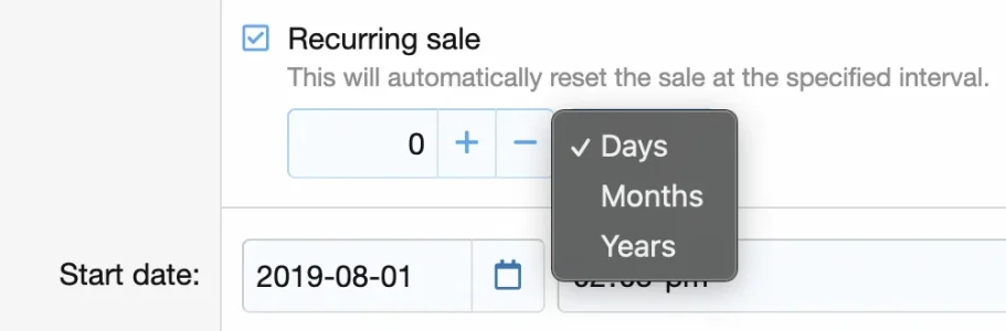

Also, sales can recur automatically:

Recurring subscription payments are different from sales.

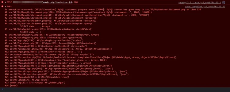

After installing the plugin began to have an error when importing the language. And I can't set another language.
I've tried older versions Dbtech ecommerce, still the same error. Because of this error I can not translate the plugin into my language, the translation is not saved :(
You can temporarily disable the "Add a call to our JS file" template modification and re-enable it later.
I turned it off. I also tried turning it off and on. But the import of another language still does not work. Phrases in templates cannot be translated either, they are not saved.

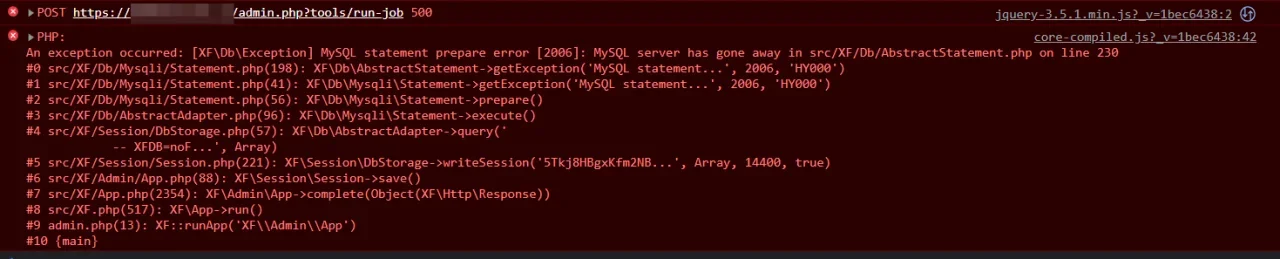

The following error occurs in the browser console.
Solved the problem as follows! Maybe it will help someone for the future.
Increased limits:
wait_timeout = 28800
max_allowed_packet = 8M
reboot server mysql
Now everything works! Yay!
