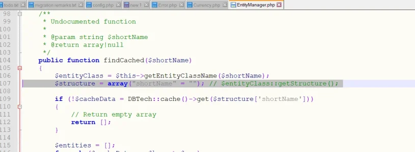

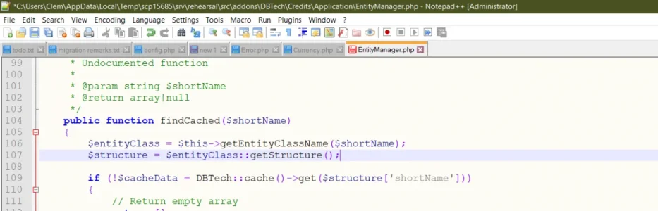

I'm going to hack into it to stop that error from happening but damn it is annoying!
I had to do this to unlock my site:
Before (line 107): in src/addons/DBTech/Credits/Application/EntityManager.php
After (line 107):
By doing this, the site is back to normal and I was able to resume the running jobs.
I'll revert back to the original code once the upgrade is complete.

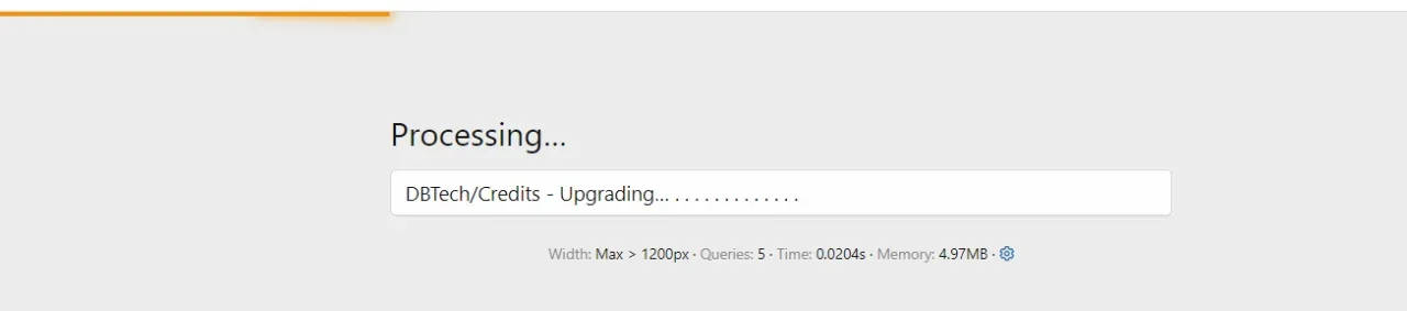

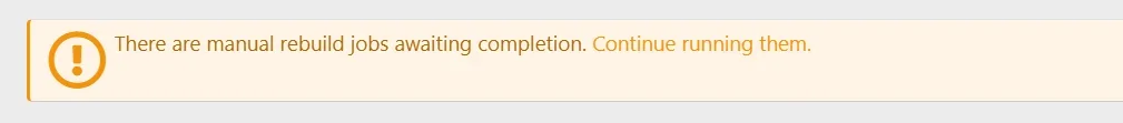

now there's something else that I'd like to ask about : the admin CP shows this message every few minutes:
Everytime I click the link to continue running them, I get this:
And then it takes me back to the admin CP homepage, and the message disappears. Until a few minutes later - the message reappears over and over.
What can I do to suppress this, is there a task that's not going through or something?

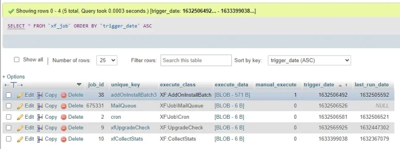

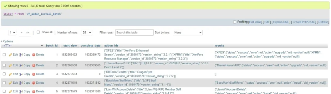

my tech guy said this:
It happens when this manual job becomes the first in the job table
If you look in the addon_batch table:
So I think XenForo is failing somewhere internally to upgrade the DBtech addon
I wonder if we can just delete that manual job from the table?
any thoughts @DragonByte Tech ?
