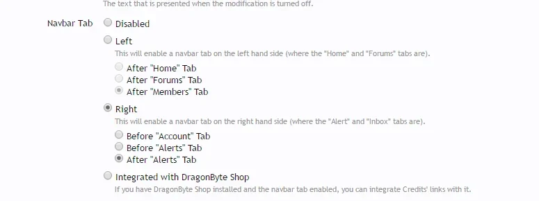

It was actually fairly easy to work out, go to the dbtech_credits_navbar_right template and find & remove

Turns out your skin does not like subnavs on right-side tabs. That's something you won't have to worry about once I can add proper support for currency labels on the navbar, as you can use it in the left side instead :)
