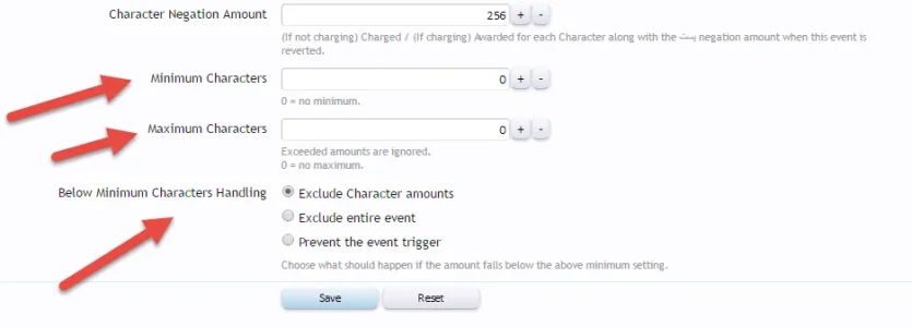

I've noticed there's an option for awarding points for posting, however would it possible to implement a minimum amount of characters to post? This would help prevent one word spam.

Finally, on my current addon editing a post still grants the original reward, does that happen on here?
Yes and no. When you edit the post, the event will be "negated" (or reverted, but "negating" is the terminology used). In the event settings, you have a "Negation Amount" setting, which is how much you want to take away when the event is undone.
For posts, and for you, this is relevant as you would set it to the same amount as they got when they first posted the post, so it would end up being
Awarded (First post) -> Negated (saving edit) -> Awarded (post saving edit).
The reason why this is happening is that the Post event has support for giving a variable amount of credits based on the number of characters added to the post. For instance, if you give 0.01 extra credits per word posted, a post might look like this:
Awarded 5.03 credits (first post, 3 words) -> Negated 5.03 credits (saving edit) -> Awarded 5.06 credits (post saving edit, 6 words).
Does that make sense? Feel free to let me know if you need any further information :)
