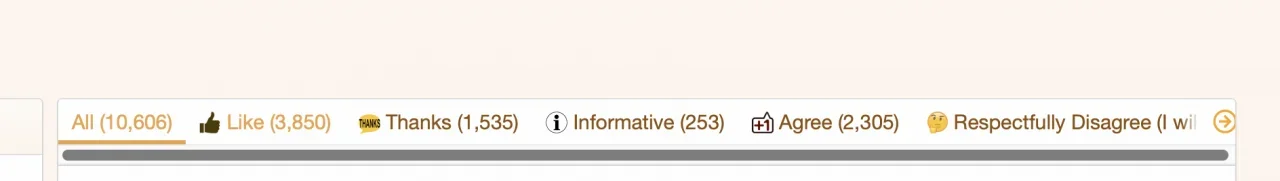

All the ratings types import fine, and shows reactions with the count for each one
