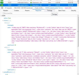

4) By far, the most common complaint right now is people not being able to disable the chat from the chat tab. Since the option isn't there a lot of my members are confused. A more elegant option would be to control whether it appears anywhere else on site.
5) Your chat sends an immense amount of what seems to be presence data. I rolled this out and suddenly a hundred and fifty people were having less fun on my site. To be clear, Blueimp's chat handles this far more gracefully, so I expected yours would to. You don't seem to distinguish between doing a full poll for everything and just the bare minimum as far as I can tell.
6) The popup window isn't scrolling on chat updates.

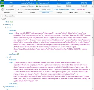

You're sending duplicate presence data in successive requests. You're sending presence data for rooms people aren't currently in. You're sending presence data as full html blocks. You're sending duplicated information in individual presence responses. You're even sending this full presence data when the widget window is closed, (like when you set it to 'all' and close it at the bottom) because your addon doesn't distinguish between requesting the minimum information possible and absolutely everything.
You're also making these requests via POST. There are configurations where php ends up processing POST requests rather differently and it locks all child processes. I imagine at least one person installed your addon and just figured their server wasn't capable of handling it.
1. Interesting. Will look into that.
2. Implementing this won't be a problem, as long as more users are requesting this feature.
3. I thought you were referring to room list, not tabs. The change doesn't look good to me, to be honest. The reason I designed the tabs the way they are is to make it look more clean and simple. I have added style properties so that admins can make it how they want.
4. It is by design as I don't see the point of disabling chat on the dedicated page since you can just leave the page.
I think I have mentioned this before but I plan to add an option to request user list every x seconds, rather than on every request.
This is by design. It updates all rooms you have joined, not just the one you are viewing.
That's because this is a 100% XF add-on and uses XF methods and menus. I think this can be improved by retrieving only minimal data and get full list if new users have joined. I will play with this soon.
I don't understand what you mean by this.
Yes, but once closed, refresh interval resets to 60 seconds.
You are right. I've set it to GET for the next release as it makes more sense.
Or you could use a timestamp to note whether or not presence data even needs to be sent. Presence data is expensive.
4b)
Presence data is expensive. Especially when polling, you need to consider if it is appropriate to send it at all.
4c)
Awesome.
4d)
Won't be an issue if you resolve the above, but the user id gets sent twice.
4e)
Again, presence data is expensive. It doesn't even get seen by e.g. mobile users.
You should really be requesting room presence data as a different sort of update request, or a modification to your standard poll. Is the userlist actually visible to the user? Then ask for it by room. If not, don't ask for it.
