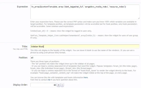

I have a sidebar on ALL but i need to know how to exclude it on a 'few' Pages we have, how can I do this?
Which pages are you looking to exclude? The most easy way is to use this in your expression:
PHP:
$_WidgetFramework_positionCode != 'thread_view'
PHP:
Lets say just Pages I create in Xenforo so it would be site.com/pages/(name of page here)

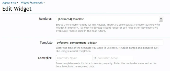

@xfrocks I believe there is a bug in Widget Framework.
I have created an advanced template widget to show our latest competitions and put the template into it as required.
However the widget is not showing in the sidebar.
The template uses the XF simple cache variable which was made available to xenforo templates as of... I think 1.2. {$xenCache}.
I'm betting the WF doesn't take notice of the {$xenCache} variable which we use like this:
{$xenCache.competitionsCache}
That's the equivalent, in PHP, of:
XenForo_Application::getSimpleCacheData('competitionsCache');
