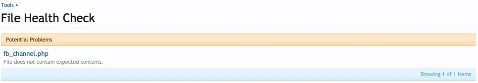

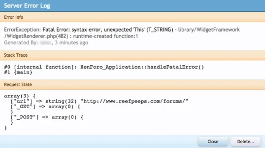

Hello Gang,
I'm getting an "Server Error" that looks like is might be related to "Widget Framework". I reinstalled the add-on files and cleared the log but the same error popped up right away. I then did a "File Health Check" and the "fb_channel.php" came back with unexpected content.
I'm not totally clear on what the "fb_channel.php" does but I'm guessing Facebook stuff? This leaves me to the next bunch of into. A while back I change my domain name and the name of the corresponding Facebook page for the forum. The Facebook block and integration didn't work after that do I made a new app on Facebook and adjusted the "Facebook Integration" and all seemed good. I just noticed today that I was getting "server errors" on the ACP that started Feb 17th. Why I didn't notice the yellow server error notice in the ACP until now is beyond me... I'm in there everyday!
That all being said I feel the need to mention that I'm not too web smart so if you have any ideas to what might be the problem and how to correct it I would appreciate it if you would speak slow and clear to me as I palpably will have to Google 99% of it just to understand.
Many thanks,
Nick
