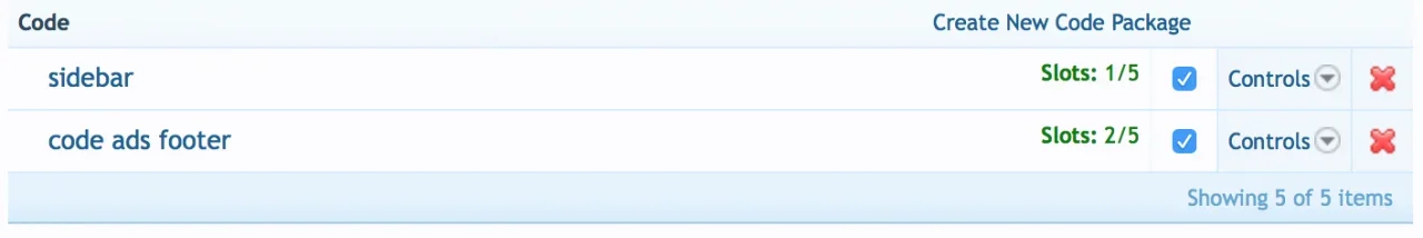

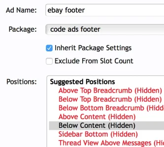

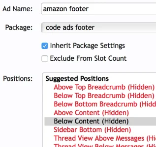

Hi, still having problems with rotating ads. have done the following:
created a package for footer ad, set this package to display on 5 nodes, the package has 5 slots
created a banner ad (code), set to inherit from package
the banner shows up fine
created another banner ad (code), set to inherit from package
the second banner will not display. have triple checked, both banners are active, part of the same package, set to inherit design
thanks for any help

The rotation is controlled via package settings.
If you want to display one ad a time randomly, you set "Maximum Ads Displayed" to 1 and "Ads Display Order:" to "Random".
If you want to rotate all ads at the same time without page reloading, you set "Maximum Ads Displayed" to the same value as "Maximum Ads Allowed" and "Rotate Ads Using JavaScript" enabled with 5 seconds or so time interval.
That helped a bit, at least the google ad and amazon ad now show, not having any luck with the ebay ad, do you know of any issues with ebay ads displaying? It works in a straight browser page but not in the xf system.
I've seen issues with ebay ads before and "Render-Blocking JavaScript" console errors due to ebay ads. Do you see any errors in the browser console?
