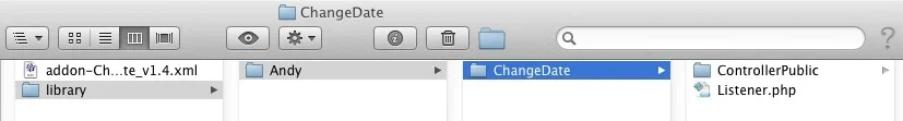

I just looked at AndyB's ChangeDate add-on and it seems, he has /library/ and the xml file in the root…
so I'm guessing that's part of the issue.
EDIT
: So my assumption is, if an add-on has /upload/ as the root folder then this Add-on Install & Upgrade program should work alright automatically. However if an add-on does not have /upload/ as the root folder, it's best to just manually upload (i.e FTP) the files for such an add-on and then import the XML file.
