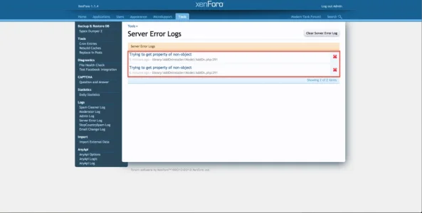

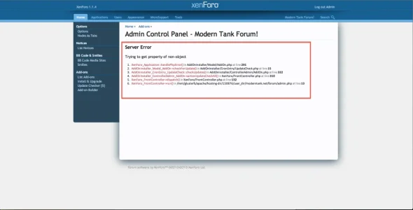

Can anyone please help me i am getting an error here are some pics of what it looks like this is with in the admin cp and here is the error that is giving when i look to see the error and the 2 pics that are attached is what it looks like it my admin cp
ErrorException: Trying to get property of non-object - library/AddOnInstaller/Model/AddOn.php:291
Generated By: Admin, 5 minutes ago
This is caused usually when the update checker can't find a version number. It's basically how the update check works. It looks at the version string on the resource and compares it to your installed version.
Some resources don't have version strings because they are file less. Likelihood is, one of the URLs you've provided doesn't have a version number.
Remove or update that URL and the error will stop. The error is silent, by the way. It logs it but no one actually sees it unless they run the update check manually or look in the error log. So don't worry. Your users won't see this error. The next version handles the error much better.
