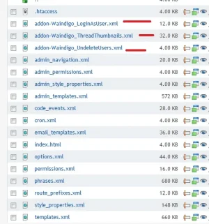

Okay so what about these three files marked in red? How come Waindigo's is the only addon xml files there?
Ah yeah, I think all of Waindigo's add-on XML files are copied into that directory. The rest of the stuff is important.
