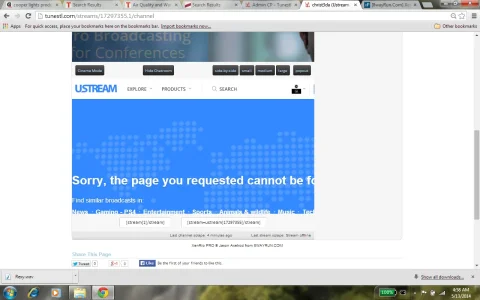

We've been using it for a month or two. It happened suddenly last night. Should we just try uninstalling and reinstalling?
This is all i see. It doesn't make any sense because it clearly has embedded the link. Any suggestions on this one?

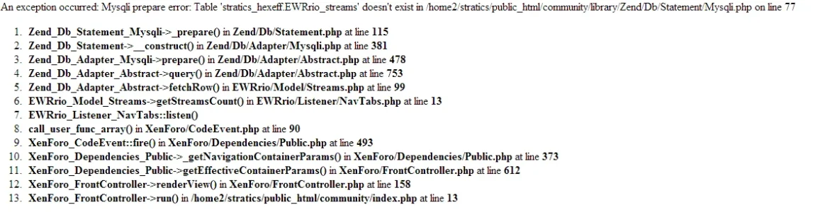

Hey Jaxel its been a while and this problem is not fixed. I have not received an answer on how to fix this problem could you please help me. Its been almost a month with out being able to use this service.
We used XenRio Pro for months. We had some file issues on 9 May. Now, when I activate the plugin, this happens.
I can hire a DBA, but I don't know how to instruct him where to look or how to fix this. Could we have some support?
It looks like the table got deleted somehow. Look into the install script to see how to recreate it.
