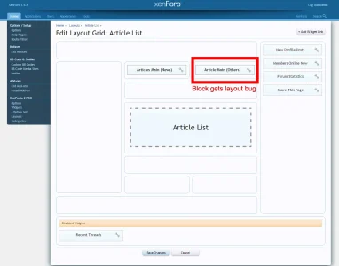

The empty space is not between articles, it's only after exceprt of the first article and only in the right block.
I have not put in in side bar. I put it here (image below). The same widget while the left one is ok but the right one is not. I can use CSS as well but the ugly empty space could not resovle by adding custom CSS.

edit: I would suggest maybe the code in the custom widgets, a thought. :confused: Are you saying code of block? Or your widget? The layout of the widgets are different for those blocks. Or even the content layout in post may effect.

Any split section is a sidebar block and follows the sidebar themes. You CAN use CSS to fix this issue with your skin, just apply a clear: none to the psuedo:after of the articleItem primaryContent.

I found that if there is no Widget link added into Left Block, the Right Block is fine. Problem just occurs when the left block and the right block contain Widget Links at the same time.

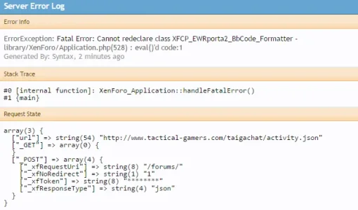

Update 1.1.9 caused the following issues which I had to revert back to 1.1.8 because of:
1) It caused an issue between XF and Taigachat that was not there prior, and is not there when reverting to 1.1.8. Stack trace below.
2) My Raw HTML widget for XenPorta 2 would no longer show. I did not look into it as I needed to revert fast so my users did not continue seeing the above error prompt every 5 seconds, so I may have been able to fix it, but I would hope an update wouldn't cause part of that product to not work. All I know on this one is that in 1.1.8 the Raw HTML widget works, in 1.1.9 it did not.
Here is the error from issue 1 above, which happens on 1.1.9 but not on 1.1.8. Must have changed how XF works with other mods too.
