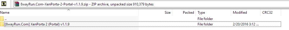

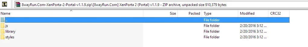

What upgrade script? The download link I got via email for the update only had the three upload directories, no script.
The root of the zip has:
And inside there is:
So I disabled the addon, uploaded the new files, enabled the addon.
To run upgrade script: Go to AdminCP > List Add-ons > [8wayRun.Com] XenPorta 2 (Portal) PRO > Controls > Upgrade Addon >
  • Upgrade from file on server: "library/EWRporta2/addon-EWRporta2.xml"
That worked, thanks. With every other addon I use (about 20 of them, most paid), I've been conditioned to see an upgrade script in the root of the archive which I use after the file upload. I've never updated from file on server because I always see the upgrade xml in the root and use that. Now I know for the future that EWRP2 doesn't do it that way (and doesn't name the upgrade xml with anything relating to "upgrade" or "update", hah).

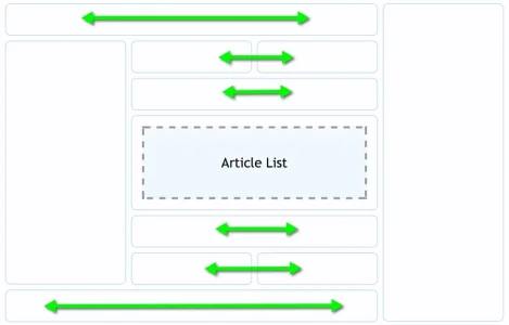

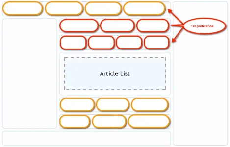

Thank you so much for adding the two columns in the layout grid... However, would love to have 3 or 4 columns or even a custom option to have as many columns as i like to pass the information as i like... and even make multiple columns available almost every where...
