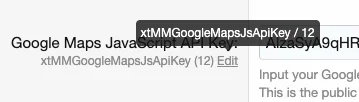

Google Maps API Key has been set with restrictions for the 3 API's listed, and server IP addresses
Google Maps JavaScript API Key has been set with restriction for the 1 API listed, and domain referrer ( .mydomain.com/ )
With Google Maps JavaScript API Key empty, still get the error.
Google Maps API Key needs to also have Google Maps JavaScript API active, otherwise error above
Google Maps JavaScript API Key with a key value, gives error above.
This is error is shown in the options page?

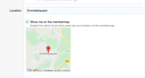

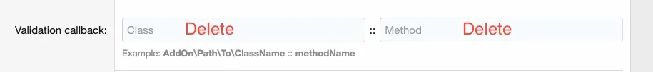

@Mouth could you please try a little workaround for testing?
You must enable development mode and modify the options for the Google Maps JavaScript API Key

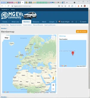

I've installed it here:
everyone (members and guests) have permission to view the map.
I have rebuilt the location data and set all users to be viewable on the map.
I have created and saved the API keys. It's the same key for both key boxes.
No pins are shown on the map.
And my location is not showing as Coventry, UK, where it is set.
Where do I start looking and if this is a common problem, please maybe add it to the FAQ?

@Stuart Wright thanks for showing me your map in guest view. It reminds me that i have to do some template changes for buttons and widgets in guest view. ;)
I never assumed that one page will allow guests to view this... but yes. We need to consider this more.
