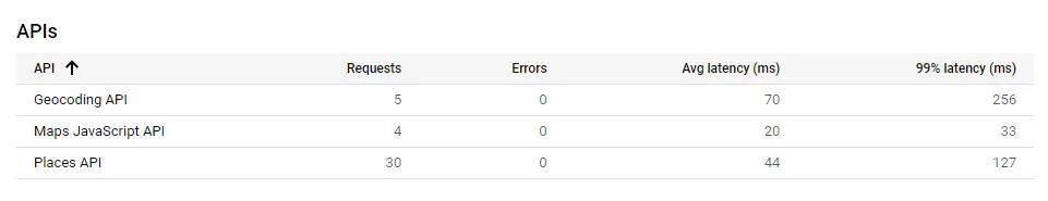

The API key is unrestricted for testing
These are the ones I have enabled on the account:
I'm not sure, I tried to find them, but I can't see anywhere in the google cloud console to see what they are, which isn't that useful.
FWIW those errors look old. The count of 11 is from the last 30 days and haven't really used the site in the last 30 days (it's a staging site), the recent request count of 5 is from the last hour.
Here's an updated chart of call from the last hour, no errors, but still getting the minimap error and console error.

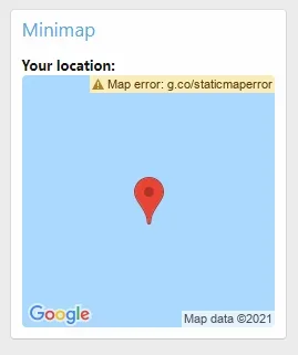

Cause the minimap, do you use CDN or CF or something else?
No CF, CDN or any optimisation tools.

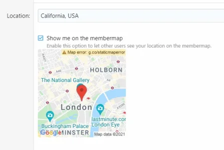

It seems to be loading a static image from /data/xtminimap/0/2.png
I tried looking at this but couldn't' find any requests in the network tab with a X-Staticmap-API-Warning: header.
I was using the same key for both key fields. Trying two different ones and same result,.
Ah, progress!
Now correctly loading London, UK, but still getting an error
Also if I change the location again it doesn't update.

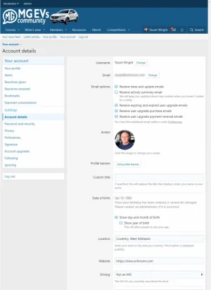

I set the location using the location autocomplete in account details.
When I deleted the image from the /data/xtminimap/ folder, then reloaded the page it created a new image of the correct location and pin
(London ,UK)
After that if I change the location again, it doesn't update seem image below

The minimap is weird. :unsure:
It is indeed. Is it using a different API from the main map?
If so, why not just use the same one so you can also zoom in and out?
