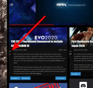

@Jaxel this is awesome - thank you for adding that into an update. I have offset date block ticked in my style properties, it shows the articles with the dates as per usual.. I have stickied and also used sticky to article index but I still get the date versus a pin.
Am I not pinning the messages properly or missing a setting? I have reviewed the add on settings and style property settings - but have not seen something. Think I could be overlooking a simple solution/fix?
Try rebuilding the addon... and reverting templates... it should look like this:
Love it. I did a rebuild of the add-on after I did the upgrade, just in case that was needed to do anything. I don't believe there is much, if anything, special done to my themes code with regard to XenPorta2 other than we use a red colored "ribbon" with white text. Did some hunting in template modifications, but don't see anything relevant.
Any idea where it might be best to look for something causing an issue or conflict? I can rebuild again and try. I did go in and "un-pin" and "repin" just to see if that might help. No luck yet :( -- but it will be awesome once I can figure out what is the culprit that's making it not work.

You are pinning the article promotion, not the thread itself, right?
Yea I am making it sticky via article promotion - by ticking where it says "Sticky to article index." Is that the proper way?
I am looking under outdated templates and I found a template where it has the coding to add the thumbtack shaded - so it may be an issue of my templates not being merged, but they will not auto merge.. so trying to see what I can do with it. I think troubleshooting brings it down to the template not merging.
In my case it was set 'Enable list view '.... So i suppose it won`t work whit that.
