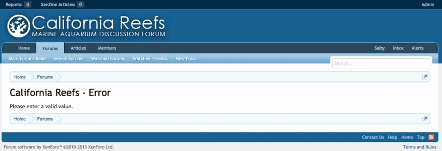

Hello Gang!
I was wondering if there is more to converting a thread to an article then I’m aware for. I open a thread, select convert thread to article and convert but I keep getting an error. I’m guessing it has something to do with not being able to select a category as nothing shows up in the category bar for selection for some reason. Does anyone know what I’m doing wrong?
Thank you for your time!

No, if you have only 1 Article Forum, move the thread into that forum before converting it to an article (Since this is where the thread will eventually exist)
To convert a thread to an article, the thread must be in a forum that is associated to an Article Category. If the article has an associated discussion, this then ensure the discussion is put in the correct place
