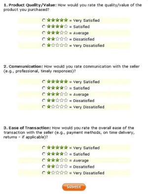

I have not purchased this but im looking into doing it. I just have one question. Is it possible to add custom user fields on the page where you leave the feedback? Where it says "I am" "The buyer, "the seller" etc.
See image for example, also whatever input is given should reflect on the feedback page just like the thumbs up and comment etc.

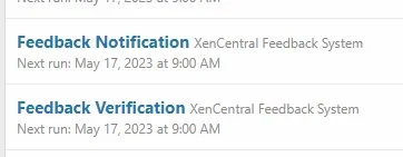

The add-on has two cron entries which seem to run hourly, but I don't know what either one does. I would think one of them updates the cache?
XenCentral\Feedback\Repository\Notification::runQueue
XenCentral\Feedback\Repository\Verification::runQueue
