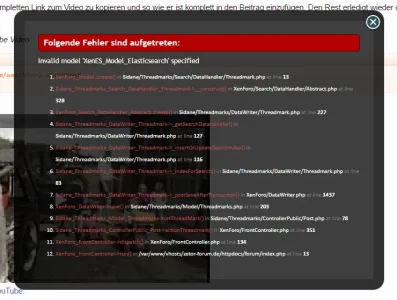

When adding a threadmark to test it, I'm getting this error:
Invalid model 'XenES_Model_Elasticsearch' specified
    XenForo_Model::create() in Sidane/Threadmarks/Search/DataHandler/Threadmark.php at line 13
    Sidane_Threadmarks_Search_DataHandler_Threadmark->__construct() in XenForo/Search/DataHandler/Abstract.php at line 328
    XenForo_Search_DataHandler_Abstract::create() in Sidane/Threadmarks/DataWriter/Threadmark.php at line 227
    Sidane_Threadmarks_DataWriter_Threadmark->_getSearchDataHandler() in Sidane/Threadmarks/DataWriter/Threadmark.php at line 127
    Sidane_Threadmarks_DataWriter_Threadmark->_insertOrUpdateSearchIndex() in Sidane/Threadmarks/DataWriter/Threadmark.php at line 116
    Sidane_Threadmarks_DataWriter_Threadmark->_indexForSearch() in Sidane/Threadmarks/DataWriter/Threadmark.php at line 83
    Sidane_Threadmarks_DataWriter_Threadmark->_postSaveAfterTransaction() in XenForo/DataWriter.php at line 1437
    XenForo_DataWriter->save() in Sidane/Threadmarks/Model/Threadmarks.php at line 203
    Sidane_Threadmarks_Model_Threadmarks->setThreadMark() in Sidane/Threadmarks/ControllerPublic/Post.php at line 78
    Sidane_Threadmarks_ControllerPublic_Post->actionThreadmark() in XenForo/FrontController.php at line 351
    XenForo_FrontController->dispatch() in XenForo/FrontController.php at line 134
    XenForo_FrontController->run() in /home/username/public_html/index.php at line 13

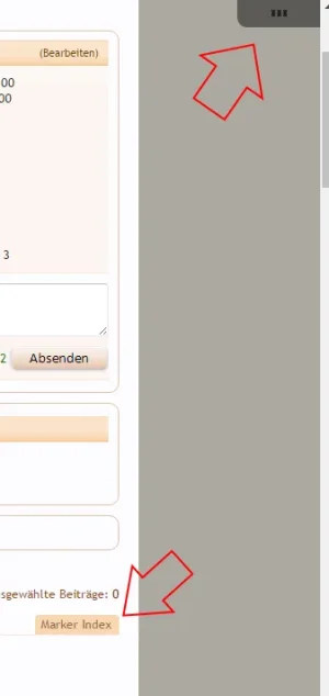

Now I cant open "view all thredmarks" (Overlay) nor the new "Index" button (next, previus do work) - bug, or do I things wrong?
And also the same as by Infopro - when I would create a new threadmarker, this come up and nothing is created:
And I have Elastic Search from Xenforo not installed. ;)

Please try this version; https://github.com/sidane/xenforo-threadmarks/archive/master.zip it should fix both issues (incorrect phrase + bad detection of Elastic Search)
Note; you need to ensure the relevant permissions are updated. I think I missed putting them in the description. There are also some options you can fiddle with too.

the Elastic Search Error is gone - good. (y)
But also after resetting the group rights, I cant acces (open) the Threadmarks "Index".
I only see for a short time a loading bar in the upper right corner and than - nothing, I see the thread view with the posts as bevore.
This is the not working index link:
https://www.my-domain.de/forum/threads/06-07-mai-2017-2-iam-a-thread.4053/threadmarks
Any idea?:unsure:
Edit: It was me - I have run th Umatrix Plugin in Chrome and this blocked cloudflare and certain google scipts - its working now. :whistle:(y)
