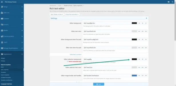

ok, so I have this user that is getting selected text inside quotes written with the same color as the background, it seems like rgb(144,144,144):
I already asked him to try it out with the default theme, but meanwhile I have tested the same scenario, even with his browser (Edge) and got nothing alike what he's getting:
How come using the same theme we are getting totally different results by doing the same steps?
What could be wrong here, and how to fix it?
Does anyone have a clue of what is going on?
Go to Style Properties and make the following change:
NOTE
: I will include this change in the next release...

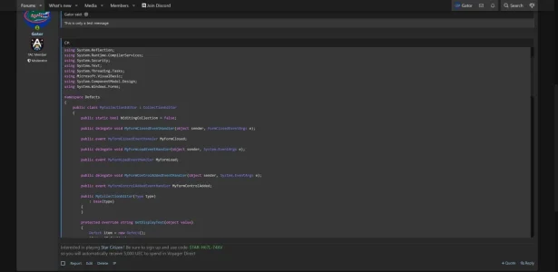

I'm getting reports that scrollbars aren't visible in quote boxes (using Code add-in) at https://csharpforums.net.
Can't see scrollbar/thumb on right side of the box.

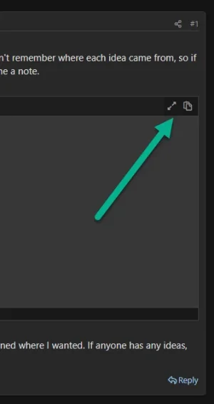

Hi @NealC, What web browser are you using?
I'm using MS Edge Chromium and this is what I see:

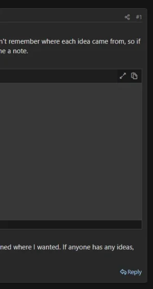

I don't know what he sees, but I'm using Chrome, and I also don't have the scroll bar there:
EDIT: I have tried on Microsoft Edge and the result is the same as on Chrome (no bar).

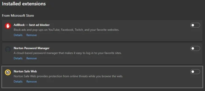

Where is this coming from? When you disabled your add-ons, did you refresh the page?
I have no idea, it has been there since ever, it has nothing to do with my extensions.
Heck I don't even use Edge, I have minimum extensions installed, and all are disabled, and of course I refreshed the page:

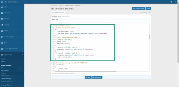

Okay, after an exhaustive detective hunt, I found the culprit. The add-on causing the scrollbar issue is...
Although this goes beyond the scope of support for this style, here is a fix for ya:
Go to Styles > Templates > Shades of Grey and add the text "!important" to the three lines as shown in the image below:
