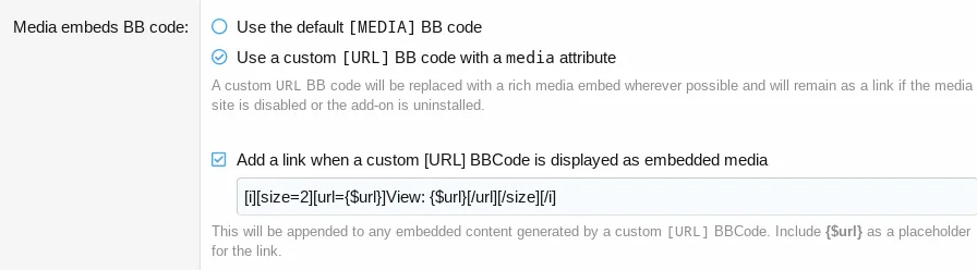

ah. so i was getting confused that having two links in the post content would result in well double links if/when the addon stops working. installed and the link only appears in embed mode and is not made part of the post content like the option xenforo has for embedding. so it works on all existing embeds and can be enabled or disabled at any time. seems like a good option to keep enabled i suppose.
it's in the screenshot. full code is editable. i edited it to link the source to the keyword Source instead of actually showing the link itself.
Yeah, I second that. A small question, however: Would you be able to add a phrase for the "View" part of the link?
No, the snippet used to create the link follows the same rules as user input, so you don't have access to template functions such as phrase(). I thought long and hard about how to make that option configurable, whether it's as BBCode, HTML, or a template and I chose the BBCode route for its familiarity as the option is modeled after XenForo's autoEmbedMedia option. I actually wrote down some notes while working on it. So you can use your own phrase in the option but it will be static.
