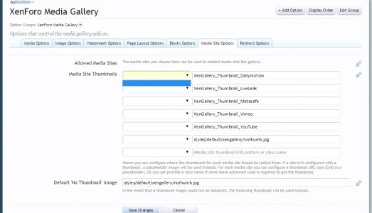

@JoshyPHP I want to keep your addon installed and up-to-date because I love a lot of the media codes. But I want to use the XF default youtube for XMG playlist thumbnails. So if add youtube to "Excluded sites" in your options page, and then run a query to add back the default XF youtube media site, will that work? Will that setting also prevent the XF youtube media site from being rewritten with your version when I upgrade?
Thanks a ton!
Yes. If you put "youtube" in the "Excluded sites" field then it will never try to overwrite it again.
