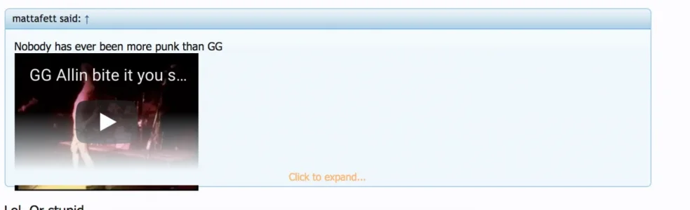

When somebody post a video from youtube and other quotes him the height of the iframe goes over the quote block
That seems like a styling issue. Notify the style authors and there's a good chance it'll be fixed using CSS.
Similar issue for us using default styles, but the YouTube embeds overflow even in the first quoted message. This issue was introduced after installing a recent update to the add-on.

@Gene @Glats Try the latest update. It fixes this issue on my local board but it may also have unintended side-effects that makes it unsuitable. You can revert the change by disabling the template modification named s9e_quote_collapsed_css
I'm not sure whether there's a silver bullet here. At the time I'm writing this, the default style suffers from the same issue, although I can't reproduce it reliably for some reason.
JoshyPHP
Potentially none of the above. HTML doesn't provide anything to support responsive iframes so they're implemented using dubious CSS hacks involving proportional padding and repositioned elements. Chrome and Firefox disagree on how to apply overflow to absolutely-positioned elements and I don't know which one is right. (edit: most browsers side with Firefox so it's probably a Blink issue)
So it's either a Blink issue or the natural consequence of not having the right tools for the job and having to make do with what we have. Both XenForo 2.0's default media sites and this add-on's use the same CSS technique, that's why both are affected.
Gene
The experimental update resolved the problem for us- and so far, haven’t noticed or heard about any new issues being introduced.
