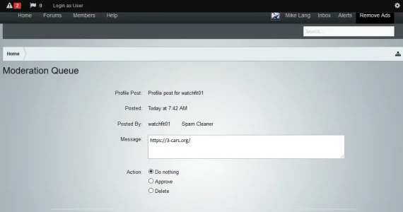

Just came across this...So when you get the exclamation red flag top left & click on it to approve/kill potential spam, you get to this page...

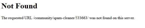

Next I always click on the "Spam Cleaner" link since that will both delete the content & ban the user. But now when I do that I get this screen:
If I turn off this plug-in the clean spam option goes away, thus I am checking with you on it to see if you can please test to see if this is a bug.
NOTE: In the ADMINCP for the user, under ACTIONS, it does work correctly.
