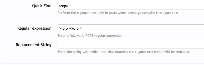

I got this working on a couple of mods but need help with reg expressions to replace these bbcodes
[box-left]
<o:p>
(this one is actually a smiley from VB4, need it removed not replaced).
also need to replace this:
[SUP]12 [/SUP]
Imported from VB4 and lots of old smilies now show as plain text

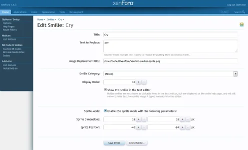

Like,
:cry:
How would I properly find/replace this with no text, so essentially just remove them? I'm sorry but I don't know regular expression stuff.

It's not necessarily the best solution simply because the only reason to get rid of it is that you say it doesn't work but :cry: is a valid smiley if you want it to be and the default sprite includes it. The only thing you need to do is create a new smiley setup like the following below.
[box-left]
<o:p>
[SUP]12 [/SUP]
The following expression did the trick for me... (y)
