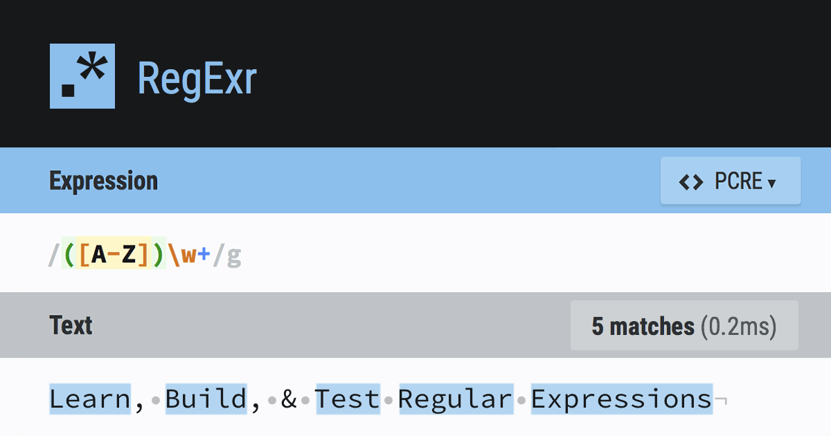

You can test it at no risk in a regex tester like this:

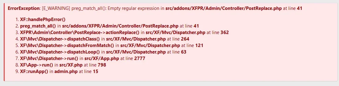

i have error
ErrorException: [E_WARNING] preg_match_all(): Empty regular expression in src/addons/XFPR/Admin/Controller/PostReplace.php at line 41
XF::handlePhpError()
preg_match_all() in src/addons/XFPR/Admin/Controller/PostReplace.php at line 41
