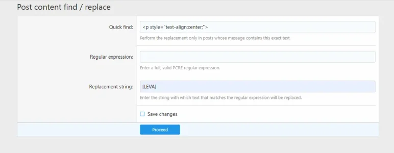

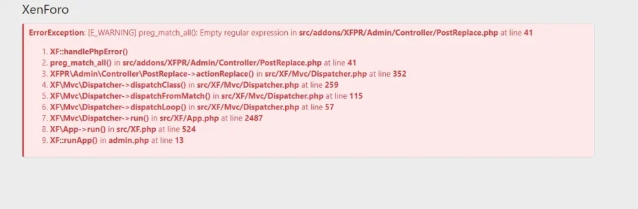

Any ideas as to why only the first hit gets replaced if there is a few that needs to be replaced in a singular post?
I need to remove some html code that I brought with me from a forum import.
But I have the following error...
How can I do?
Thank you

We found the answer to the error: no matter what you put in the Quick Search and the replacement string, YOU MUST put something in the Regular Expression field (you can't leave it blank). So put the regex version of your search string.
Once you do that, the add-on works perfectly. press proceed to check if there's an error in what you put in. If all goes well and you get a result, just click save and proceed to apply the changes. :)

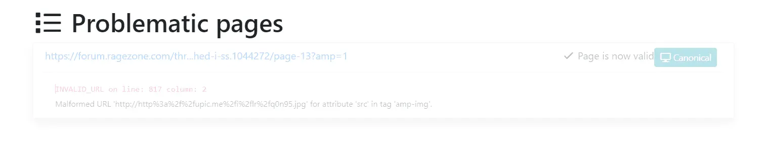

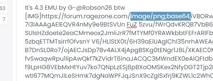

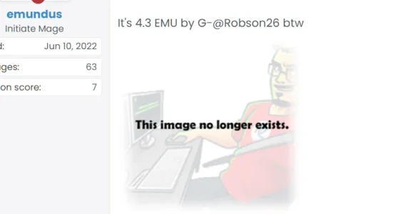

Another for those whom had vBulletin migration errors due to some obsolete vB version bugs. In this instance, I had around a 1000 broken messages which embedded an image as the following;
image/png;base64,
To work around this, I've removed the content.
Query
UPDATE xf_post
SET message = REGEXP_REPLACE(message, '\\[IMG\\]https://forum\\.domain\\.com/image/png[^\\[]+\\[/IMG\\]', '[IMG]https://forum.domain.com/images/404_image.png[/IMG]');
To work around the Regex limit, via MySQL set the following;
SET GLOBAL regexp_time_limit=0;
You will also need to bump up your php limits.

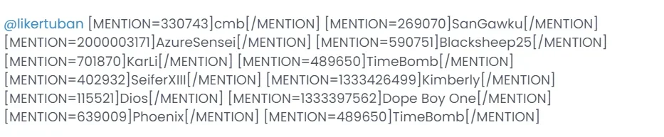

How to remove BB codes of this type using this plugin: [MSNAPBACK]694562[/MSNAPBACK]
