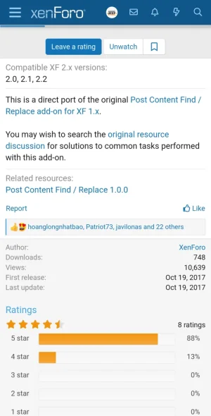

How do I run this code?
Works on my old XF 2.2 archived site. Are you on XF 2.2 or less? States only supports XF 2.0, 2.1 and 2.2.
