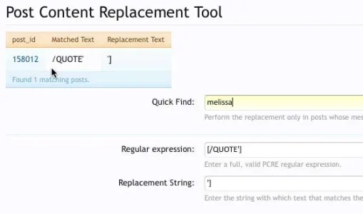

Not quite working as expected. I want to replace
[/QUOTE']
But the matched text is missing the square brackets. How would I get this to include the brackets (which i thought can be part of a regular expression? Thanks
You need delimiters in your expression because they tell the regex engine the start and stop point, the way you setup your expression it is using the [ and ] as starting and stopping points, also when you want to match a literal [ you need to escape it so that regex doesn't think you are specifying a character class (like a-z which is [a-z]) which you would do like this \[.
You expression to match
[/quote']​
would be
#\[/quote']#siu​
