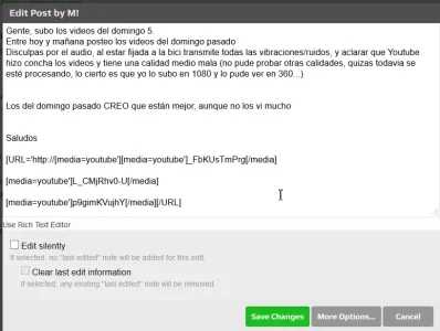

Thanks, that worked, we're getting closer, but now I have to fix this ones.
Just in case, this is what I see in the BB Code Editor when I edit the posts.
[URL='http://[media=youtube'][media=youtube']OtkOofSswP4[/media][/URL]
And...
[URL='http://[media=youtube'][media=youtube']KQwmcGI33q0[/media]
[media=youtube']Ph-nR09RiYE[/media]
[media=youtube']kKMO5_iTyTg[/media]
[media=youtube']k7c7-QzcTxo[/media]
[media=youtube']6BT6jBjulZ8[/media]
[media=youtube']0FJVi52NUn4[/media]
[media=youtube']nihHG4YH2SQ[/media]
[media=youtube']nUHN3iUfAtg[/media]
[media=youtube']GjvFBZbP2Gg[/media]
[media=youtube']wGrHLnOaQyM[/media]
[media=youtube']QSqlKDDEYqs[/media][/URL]

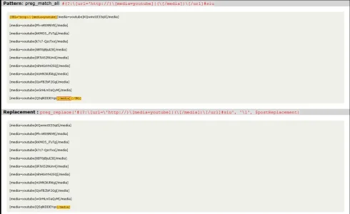

Yeah i just noticed that there is an error in your bbcode from before we started. Run this to fix that...
Quick Find:
youtube
Regular expression:
#\[media=youtube']#siu
Replacement String:
[media=youtube]
Then run the following to clean up that url then double media tag as well as the closing media followed by the url
Quick Find:
youtube
Regular expression:
#(?:\[url='http://)\[media=youtube]|(\[/media])\[/url]#siu
Replacement String:
\1
What do you mean it doesn't work? Like what does it show you in the addon....I just replicated that post in my db and tested the replacements and they work just fine and also tested the expression independently...
