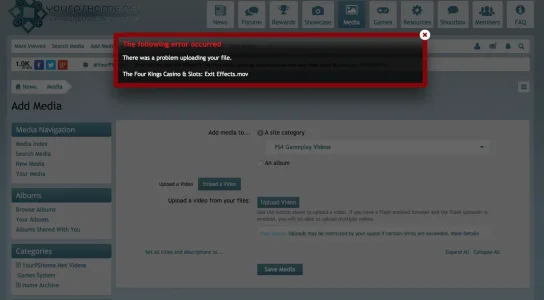

Anyway @Chris_D , small videos working fine, just tired a 450mb video and that fails, just get (All the same format and codec as the small clips):
My server should be setup for being able to handle files up to 2000mb, in less i missed something.

You mentioned Apache. There are a couple configuration values that could limit uploads. For example, LimitRequestBody. If you're using FastCGI, FcgidMaxRequestLen could be at play as well.
Alternatively, it could just be that the Flash uploader is a little less forgiving to network conditions. Try the upload with it disabled.
