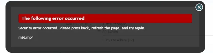

I tried to upload a video but i got this message
Security error occurred. Please press back, refresh the page, and try again.
40 mb video (.mp4)

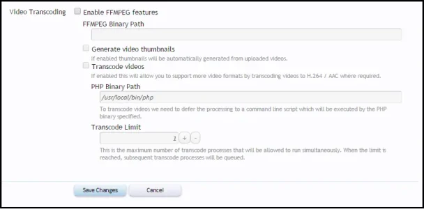

Then i went into my MG settings and i noticed that there is no settings for FFMPEG and it's not even enabled
I am assumming that's why it's not working?
I thought i wouldn't have to install anything. I remember reading that in the HYS thread.
Anyways..
So i think these are the steps that i have to do in order to get the video working?
#1 install FFMPEG
#2 enable it in settings,
#3 click on Generate video thumbnails
That's all?
Do i have to click on Transcode videos and do i have to put something in PHP Binary Path?
Also, Transcode Limit, i don't understand this, should i keep it at 1?
Did i miss anything?

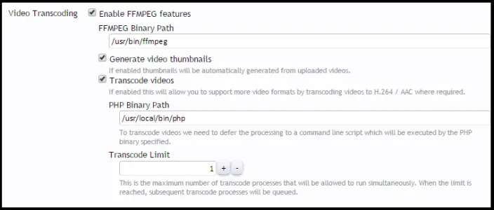

There are no prerequisites for being able to upload video and that's true because you've been able to upload the dinosaur video.
If you want thumbnails too that requires ffmpeg.
Those steps are correct. Install it, enable it by specifying the path where it was installed, click generate video thumbnails.
If you want to transcode videos to be able to accept more formats then you will need to enable that option. There's a queueing system for transcoding videos. 1 is the maximum number of videos that will be processed at a time. This is recommended unless you know your server can handle more. It's a very intensive process.
Sorry, completely forgot to address the other issue in your post...
The "Security error" you experienced is actually likely down to server configuration and file uploads. You need to make sure upload_max_file_size and post_max_size are of a sufficient size.
e.g. if you want to allow video uploads up to 100MB then you need to set the value of both of these to "100M".
You can change those values in php.ini.
Oh i see .. that was the problem. I had changed the upload_max_file_size but i didn't know i had to change the post_max_size as well. I changed it and it worked! Just missing the thumbnails

I typed in which ffmpeg and which php and i got my answers and pasted them in the settings.
If you can type /usr/bin/ffmpeg -version at a shell on your server and you get some version and other details then it should be installed correctly and it should be working correctly.

joey here reporting!
I did what you said to do in the other thread. Just replace that ffmpeg file and it didn't work at first but i waited 30 minutes (maybe cache) and it works!
Now the thumbnails show up! and video is working!
Mission Success! thank you sir for help! Mission Accomplished.
